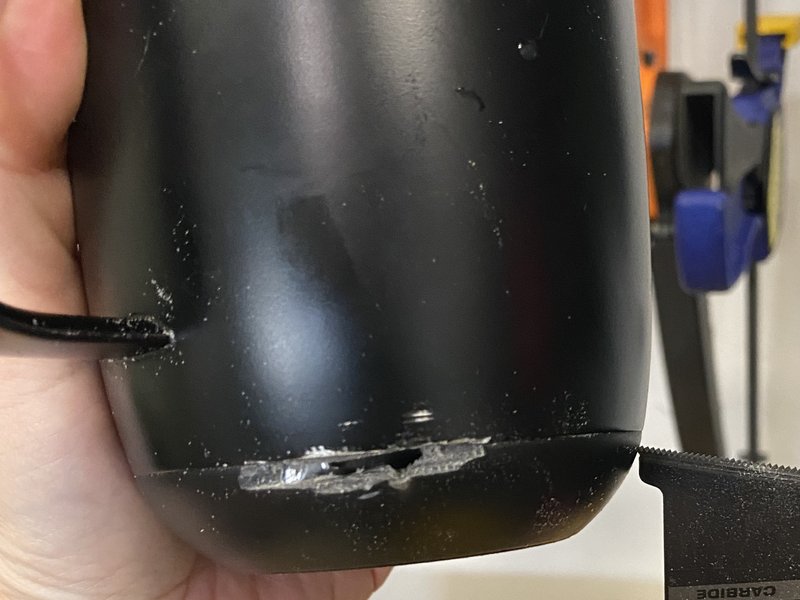

      • This is the worst part. It does not twist off manually- even with a very strong person (not me) trying. Some have claimed they can twist it off. Kudos to them. . . twisting off was absolutely impossible with this mug.
      • I held it in a vice and cut a small hole in the base right where it is attached to the mug using an oscillating saw. This was overkill of a tool but it worked.
      • Do not cut where I did. I cut on the side opposite of the "Ember" logo just lateral to the handle. This was NOT the best option, but I was lucky (see step 2). If I were to do this again, I would cut on the other side of the handle just between the handle and the "r" of "Ember" logo.
      • Wherever you cut, make sure it is shallow and angle up towards the opening of the mug to avoid the circuit board.

      • Once you have a hole, brute force the base off.
      • I used a screwdriver to wiggle the base back and forth and once I had a hole in it. It eventually twists off but only after I had created significant movement in it relative to the cup.
      • Be careful to not pull the base too hard as there's a ~1 inch ribbon connector between the base and the mug.
      • Note my terrible choice of where to put the hole- it's right next to the ribbon connector. Again, it would have have been much safer to have gone on the other side of the handle.

I used a small strap wrench- most commonly used for loosening oil filters on vehicles to loosen the base. It turns only about an eight or less of a turn clockwise while the cup is flipped upside down. Then I was able to pry the cup open just using my fingers a little at a time. Mark the cup with a line from the cup through to the bottom once turned with a dry erase or removable mark so you know exactly where to put it back together at. Use the strap wrench to twist it back square with the ember emblem. Thanks!
Isaac - Reply Share
There have been another thread on this that I'll post here for reference:
How to change the battery in an Ember Mug
In summary YOU DON'T NEED TO MAKE A HOLE to change the battery. Place the cup upside down in a wise and twist the bottom part with either a pair of rubberised garden gloves or use double sided tape to add friction (see the details in the link).
The rest of this guide is perfectly fine to follow for instructions on how to replace the battery.
