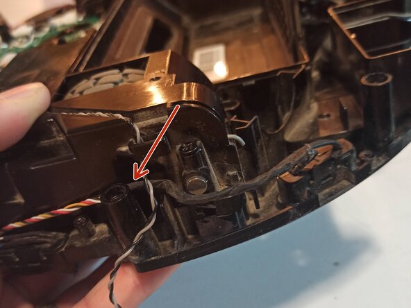

    4. Ecovacs Deebot 920 Reassembly, Concerning Wheel Wells: step 4, image 1 of 3 Ecovacs Deebot 920 Reassembly, Concerning Wheel Wells: step 4, image 2 of 3 Ecovacs Deebot 920 Reassembly, Concerning Wheel Wells: step 4, image 3 of 3
      • Each wheel well has a traction spring which pushes down on a finger in the housing, keeping the wheels firmly on the ground.
      • The finger rides along a bushing on the side of the wheel.
      • The spring-loaded fingers must be pushed up into the housing all the way, and then the wheels inserted underneath them so that the spring rests on the bushing.
      • The leeway for keeping the wheel in the appropriate location while all of the screws are removed from the wheel well is very small, so compression must be applied constantly between the wheel and wheel well to prevent the spring from dislodging.
      • The wheel should be fighting you constantly. If it is not, restart by setting the spring back onto the bushing.

    5. Ecovacs Deebot 920 Reassembly, Concerning Wheel Wells (cont.): step 5, image 1 of 2 Ecovacs Deebot 920 Reassembly, Concerning Wheel Wells (cont.): step 5, image 2 of 2
      • When fully inserted and screwed down correctly, the reed switch (which indicates to the system that the wheel is off the floor) should be fully compressed, and the plastic finger which depresses it should be at or near the top of the silver portion of that switch.
      • An incorrectly installed wheel may not depress the switch completely, and may not reach the top of the silver area. The usual culprit is a pinched wire.

    7. Ecovacs Deebot 920 Reassembly, Install The Right Wheel Well: step 7, image 1 of 3 Ecovacs Deebot 920 Reassembly, Install The Right Wheel Well: step 7, image 2 of 3 Ecovacs Deebot 920 Reassembly, Install The Right Wheel Well: step 7, image 3 of 3
      • Repeat the process on the other side of the vacuum.
      • Ensure that no wires have become trapped under the front of the housing. The area highlighted in red shows that the white/green/blue wire is pinched.
      • The next image shows that the pinch has been resolved, and a beautifully aligned reed switch.

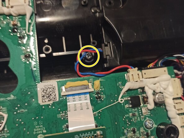

    12. Ecovacs Deebot 920 Reassembly, Install The Motherboard: step 12, image 1 of 2 Ecovacs Deebot 920 Reassembly, Install The Motherboard: step 12, image 2 of 2
      • Reconnect all wires to the motherboard
      • Ensure that any connectors underneath the left side of the board are also connected.
      • Install the motherboard and daughter boards with five silver 7mm screws.

    13. Ecovacs Deebot 920 Reassembly, Confirm Connections: step 13, image 1 of 1
      • Check over the inside of the unit to ensure that no wires are sticking out of place. Wires along the sides of the unit should be properly routed into their own retention clips to avert any risk of damage. Wires should not be loose or slack at any location, as they are of a precise length to reach their respective components when properly installed.
      • Confirm that all of the motherboard connectors are fully seated. Each connector should be of the appropriate length to reach its intended plug, and due to the size and location of each connector, there is little chance of ambiguity in connecting these.
      • Confirm that the power switch on the motherboard is towards the left side, as shown, and that the power switch slider on the top of the case is in the same direction (off).
