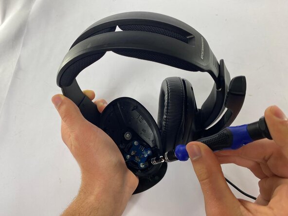

    2. EPOS Sennheiser GSP 302 Volume Wheel Replacement: step 3, image 1 of 3 EPOS Sennheiser GSP 302 Volume Wheel Replacement: step 3, image 2 of 3 EPOS Sennheiser GSP 302 Volume Wheel Replacement: step 3, image 3 of 3
      • Remove the four 7.0 mm screws holding the speaker driver in place with a Phillips #1 screwdriver.
      • Carefully disconnect the speaker driver from the earcup by desoldering the connection with a soldering iron.

    1. EPOS Sennheiser GSP 302 Volume Wheel Replacement, Volume Control Potentiometer: step 4, image 1 of 2 EPOS Sennheiser GSP 302 Volume Wheel Replacement, Volume Control Potentiometer: step 4, image 2 of 2
      • Remove the four 5.9 mm screws holding the volume control potentiometer in place with a Phillips #1 screwdriver.
      • Remove the volume control potentiometer from the earcup.

    1. EPOS Sennheiser GSP 302 Volume Wheel Replacement, Volume Wheel: step 5, image 1 of 3 EPOS Sennheiser GSP 302 Volume Wheel Replacement, Volume Wheel: step 5, image 2 of 3 EPOS Sennheiser GSP 302 Volume Wheel Replacement, Volume Wheel: step 5, image 3 of 3
      • Remove the three 6.0 mm screws holding the volume wheel in place with a Phillips #1 screwdriver.
      • Remove the volume wheel.
