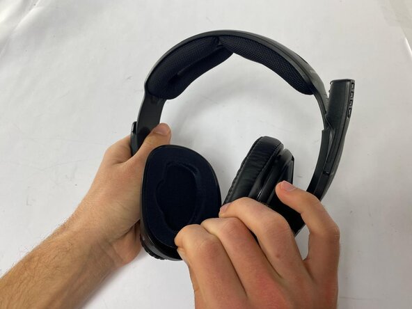

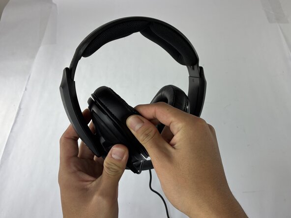

    1. EPOS Sennheiser GSP 302 Microphone Replacement, Earpad Cushion: step 1, image 1 of 3 EPOS Sennheiser GSP 302 Microphone Replacement, Earpad Cushion: step 1, image 2 of 3 EPOS Sennheiser GSP 302 Microphone Replacement, Earpad Cushion: step 1, image 3 of 3
      • Hold the headset firmly with one hand.
      • Grip the edge of the earpad with your fingers.
      • Gently pull the earpad outward.
      • Work your way around the earpad, rotating it 360 degrees until it separates from the headset.
