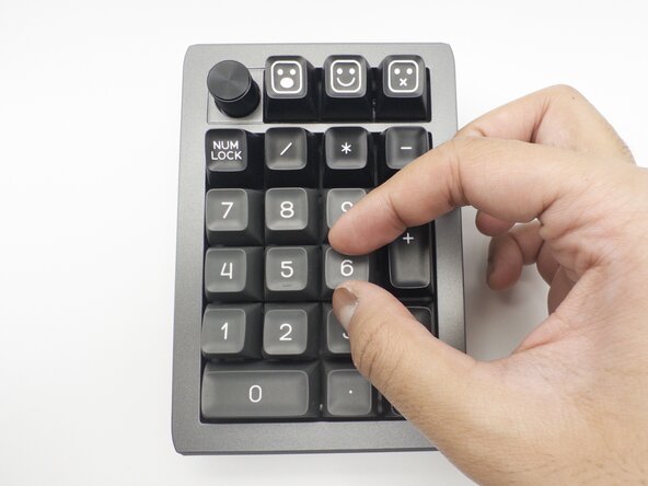

    • Ensure the USB-C cable located on the top of the device is unplugged.
    • Optional: Give the device a quick spray with a compressed air can if it seems to have collected some dust.

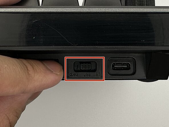

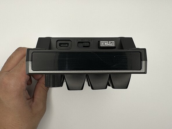

    • Position the device upright so that the ports are facing upwards.
    • Turn the device so that the ports are facing towards you.
    • Turn the switch to the USB position.
    • This will ensure the device is OFF.
