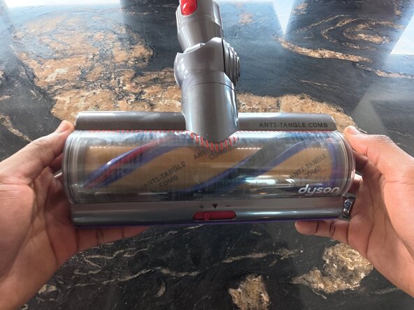

  1. Dyson V15 Detect Head Brush Bar Replacement, Head Brush Bar: step 1, image 1 of 3 Dyson V15 Detect Head Brush Bar Replacement, Head Brush Bar: step 1, image 2 of 3 Dyson V15 Detect Head Brush Bar Replacement, Head Brush Bar: step 1, image 3 of 3
    • Detach the high torque cleaner head from the vacuum wand by pressing the red release button.

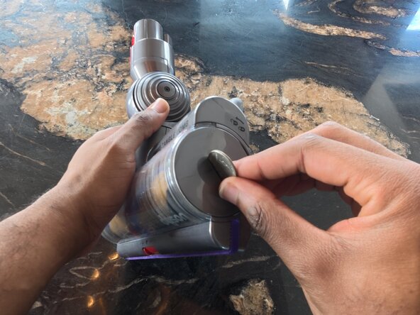

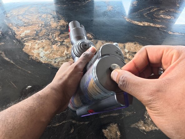

  2. Dyson V15 Detect Head Brush Bar Replacement: step 2, image 1 of 3 Dyson V15 Detect Head Brush Bar Replacement: step 2, image 2 of 3 Dyson V15 Detect Head Brush Bar Replacement: step 2, image 3 of 3
    • Unlock the end cap.
    • Use a US coin (or a 15.00mm flat-head screwdriver) to turn the end cap on the side of the cleaner head 90° counterclockwise to the "unlocked" position.
    Ask FixBot

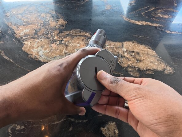

  3. Dyson V15 Detect Head Brush Bar Replacement: step 3, image 1 of 3 Dyson V15 Detect Head Brush Bar Replacement: step 3, image 2 of 3 Dyson V15 Detect Head Brush Bar Replacement: step 3, image 3 of 3
    • Pivot the end cap upward and away from the housing.

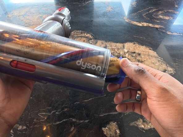

  4. Dyson V15 Detect Head Brush Bar Replacement: step 4, image 1 of 3 Dyson V15 Detect Head Brush Bar Replacement: step 4, image 2 of 3 Dyson V15 Detect Head Brush Bar Replacement: step 4, image 3 of 3
    • Grasp the edge of the brush bar (the purple and black spiraled cylinder) and slide it straight out of the vacuum head.
    • If the bar feels stuck, check for thick hair-wrap around the edges and use scissors to carefully snip the fibers.
