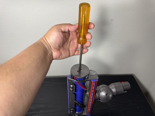

    3. Dyson V11 Torque Drive Brush Bar Replacement: step 3, image 1 of 1
      • Insert a flat-head screwdriver into the slot and rotate the end cap one-quarter turn counterclockwise until it unlocks.

    7. Dyson V11 Torque Drive Brush Bar Replacement: step 7, image 1 of 1
      • Place the flathead screw driver into the end cap by turning it one-quarter turn clockwise until it locks securely into place.
