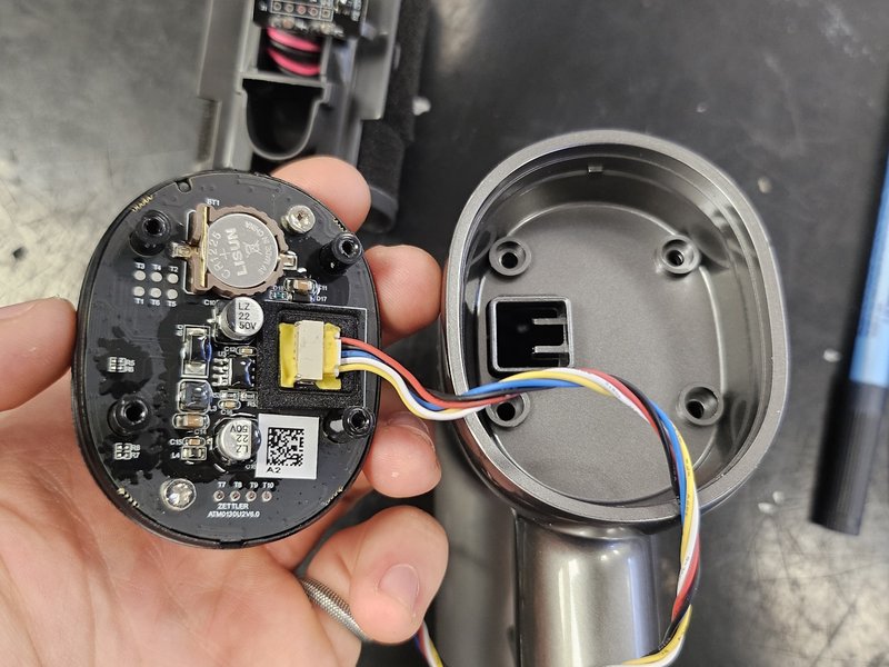

    12. Dreame T30: Display Replacement, Remove the display from the chassis: step 12, image 1 of 3 Dreame T30: Display Replacement, Remove the display from the chassis: step 12, image 2 of 3 Dreame T30: Display Replacement, Remove the display from the chassis: step 12, image 3 of 3
      • Remove the marked screws.
      • They are Torx T10.
      • After removing the screws, push the display out. I usually just use the screwdriver to do so, as it is not held in by anything.
      Ask FixBot
    13. Dreame T30: Display Replacement: step 13, image 1 of 3 Dreame T30: Display Replacement: step 13, image 2 of 3 Dreame T30: Display Replacement: step 13, image 3 of 3
      • After removing the display, simply disconnect the cable. You can now replace it or disassemble it further to replace only the display or the PCBA with buttons.
      • To do so, remove the 2 screws holding the assembly together. They are T10 Torx.
      • Once you've replaced what is needed, simply reassemble it, then attach the cable and put it back into the chassis.
