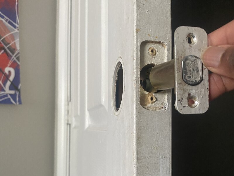

    1. Doorknob Privacy Pin Replacement, Doorknob Privacy Pin: step 1, image 1 of 3 Doorknob Privacy Pin Replacement, Doorknob Privacy Pin: step 1, image 2 of 3 Doorknob Privacy Pin Replacement, Doorknob Privacy Pin: step 1, image 3 of 3
      • Use a Phillips #1 screwdriver to remove the two screws holding the interior and exterior doorknob halves together.

    2. Doorknob Privacy Pin Replacement: step 2, image 1 of 2 Doorknob Privacy Pin Replacement: step 2, image 2 of 2
      • Carefully pull the doorknob halves apart.
      • The spindle and the latch mechanism should now be accessible.

    3. Doorknob Privacy Pin Replacement: step 3, image 1 of 3 Doorknob Privacy Pin Replacement: step 3, image 2 of 3 Doorknob Privacy Pin Replacement: step 3, image 3 of 3
      • Use the Phillips #1 screwdriver to remove the privacy pin.
      • It is a small, threaded pin that screws into a hole on the latch mechanism itself or on the interior doorknob assembly.

    5. Doorknob Privacy Pin Replacement: step 5, image 1 of 3 Doorknob Privacy Pin Replacement: step 5, image 2 of 3 Doorknob Privacy Pin Replacement: step 5, image 3 of 3
      • Screw the new privacy pin into the corresponding hole.
      • Ensure it's securely tightened but don't overtighten, as this could strip the threads.
