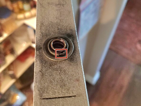

    1. Door And Window Ball Latch Replacement, Ball Latch: step 1, image 1 of 2 Door And Window Ball Latch Replacement, Ball Latch: step 1, image 2 of 2
      • Inspect the top edge of the pantry door.
      • Common signs of a failed ball latch include: Door will not stay closed, Ball is missing, Ball retracts too far into the housing, Strike plate is damaged or loose
      • In this example, the ball is missing from the spring.

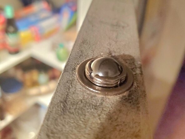

    4. Door And Window Ball Latch Replacement: step 4, image 1 of 2 Door And Window Ball Latch Replacement: step 4, image 2 of 2
      • Insert the tip of a pair of tweezers or a metal spudger into one of the adjustment notches around the new ball latch.
      • Turn the adjustment ring clockwise to raise the ball.
      • Turn the adjustment ring counterclockwise to lower the ball.
      • Adjust the ball so it extends slightly beyond the surface of the retaining ring.
