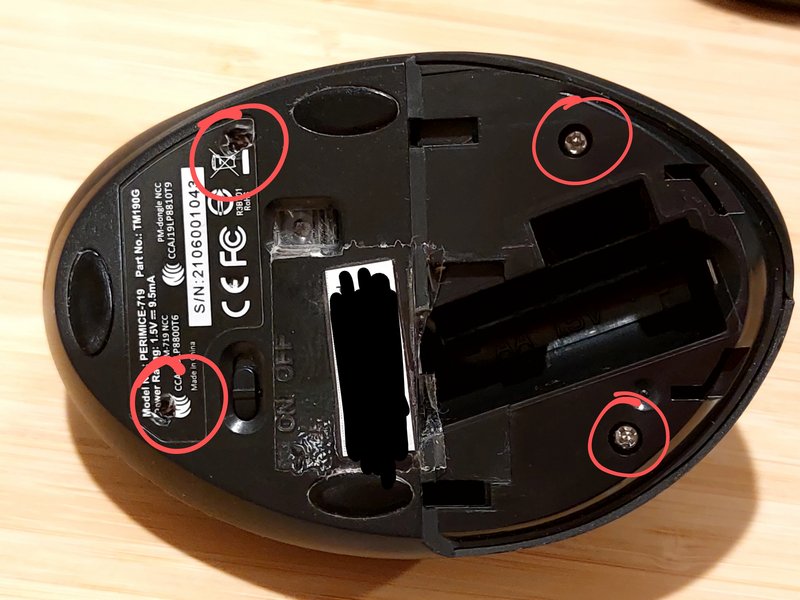

    1. Disassembling mouse PERIXX PERIMICE-719, PERIXX PERIMICE-719: step 1, image 1 of 1
      • Remove these four screws. Two are in the battery compartment; the other two are under the label.
