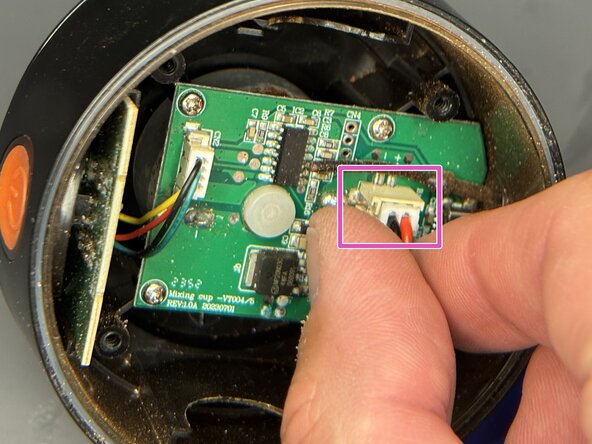

    4. Disassembling VoltrX Shaker Bottle Charging port, Remove the battery: step 4, image 1 of 2 Disassembling VoltrX Shaker Bottle Charging port, Remove the battery: step 4, image 2 of 2
      • Unplug the battery by pulling up on the two wires

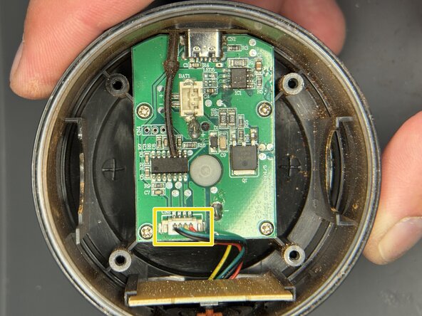

    5. Disassembling VoltrX Shaker Bottle Charging port, Uplug the On/Off switch: step 5, image 1 of 3 Disassembling VoltrX Shaker Bottle Charging port, Uplug the On/Off switch: step 5, image 2 of 3 Disassembling VoltrX Shaker Bottle Charging port, Uplug the On/Off switch: step 5, image 3 of 3
      • Unplug the switch by pulling up on the 4 wires
      Ask FixBot
    6. Disassembling VoltrX Shaker Bottle Charging port, Remove the screws: step 6, image 1 of 3 Disassembling VoltrX Shaker Bottle Charging port, Remove the screws: step 6, image 2 of 3 Disassembling VoltrX Shaker Bottle Charging port, Remove the screws: step 6, image 3 of 3
      • Remove the 4 screws and pull out the motor and charging port assembly
