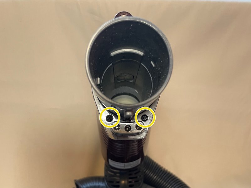

      • Remove the two tamper-resistant T9 screws on the front of the handle.
