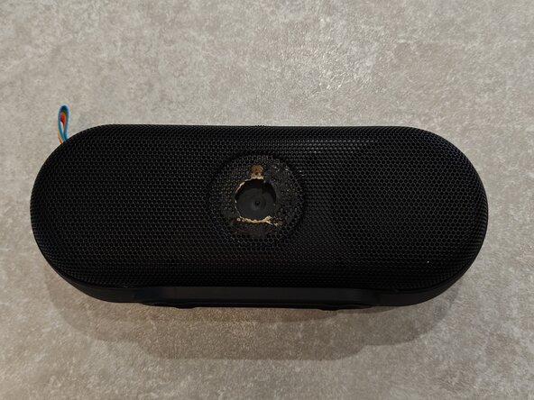

This guide is to disassemble this Bluetooth speaker, in my case it was to replace a faulty battery.

    1. Disassembling Polaroid P2 Music Player, Polaroid P2 Music Player, Portable Bluetooth Speaker: step 1, image 1 of 3 Disassembling Polaroid P2 Music Player, Polaroid P2 Music Player, Portable Bluetooth Speaker: step 1, image 2 of 3 Disassembling Polaroid P2 Music Player, Polaroid P2 Music Player, Portable Bluetooth Speaker: step 1, image 3 of 3
      • Flip the device onto its front/face
      • Using a metal spudger remove the small circular plastic plate on the back mesh. This is glued to both the mesh and the interior plastic, and will make it easier to remove the rear mesh
