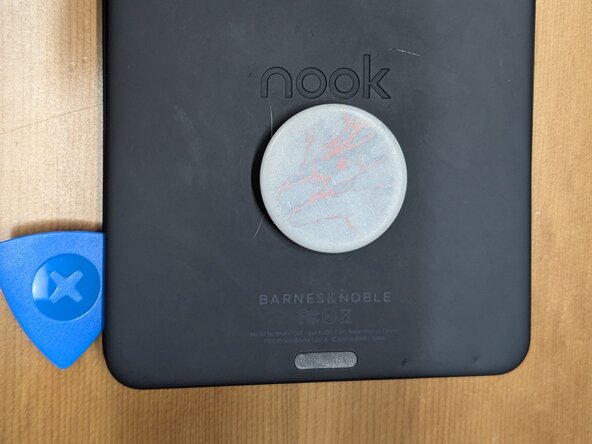

Opening the pressure fit tabs on the casing just requires something to pry the seam apart as there is no adhesive.
    1. Disassembling Nook Glowlight 4 Cover, Remove back cover: step 1, image 1 of 1
      • Pry the lip of the cover outward and insert the pick in the seam
      Ask FixBot
    2. Disassembling Nook Glowlight 4 Cover: step 2, image 1 of 1
      • Rotate the pick to release the tabs along the edge of the cover
