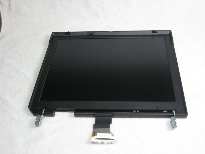

    1. Disassembling IBM ThinkPad A30 Display Assembly, Display Assembly: step 10, image 1 of 1
      • Remove the 5.6mm screw that holds the LCD to the upper case.
      Ask FixBot
    2. Disassembling IBM ThinkPad A30 Display Assembly: step 11, image 1 of 3 Disassembling IBM ThinkPad A30 Display Assembly: step 11, image 2 of 3 Disassembling IBM ThinkPad A30 Display Assembly: step 11, image 3 of 3
      • Remove the 5.6mm screw on the left side of the three-pronged connector.
      • Remove the other two 16.7mm screws.
      • Lift and remove connector.
      Ask FixBot
    3. Disassembling IBM ThinkPad A30 Display Assembly: step 12, image 1 of 2 Disassembling IBM ThinkPad A30 Display Assembly: step 12, image 2 of 2
      • Pull out the white tab connecting the LCD to the motherboard.
      Ask FixBot
    4. Disassembling IBM ThinkPad A30 Display Assembly: step 13, image 1 of 2 Disassembling IBM ThinkPad A30 Display Assembly: step 13, image 2 of 2
      • Turn the laptop so that the back is facing you.
      • Remove the four 5.6mm long screws.
      Ask FixBot
    5. Disassembling IBM ThinkPad A30 Display Assembly: step 14, image 1 of 3 Disassembling IBM ThinkPad A30 Display Assembly: step 14, image 2 of 3 Disassembling IBM ThinkPad A30 Display Assembly: step 14, image 3 of 3
      • Place the laptop so that the LCD is facing you again.
      • Gently lift the LCD monitor up and out.
      • Remove the black plastic tab.
      Ask FixBot
