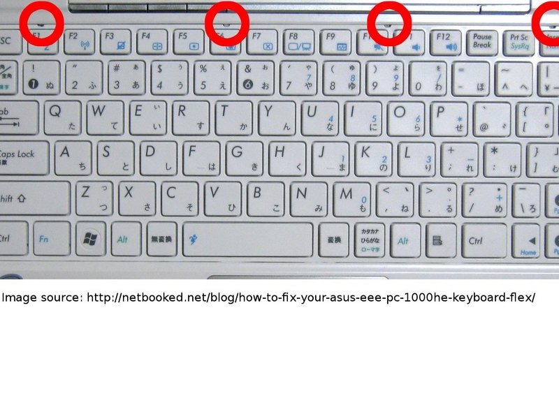

      • Turn off the power and remove the battery before working on your Eee PC
      • Start by removing the keyboard
      • There are four latches on the top of the keyboard, use a paper clip or other object to disengage the latches
      • You may have to pull the keyboard up enough with the object - there is no spring mechanism to pop the keyboard out. One trick is after lifting it enough, to slide it (not too much) upward to remove the bottom side.
      • The keyboard assembly has also two plastic retention points on the sides, and some thermal tape sticking the keyboard down.
      • Caution: the keyboard has a ribbon connector underneath it which must be carefully unplugged before fully removing the keyboard.
