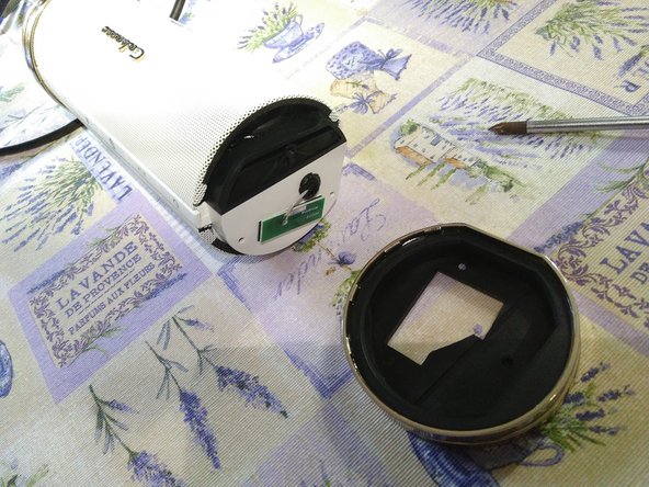

Disasembling guide for Cabasse Swell
  1. Disasembling guide for Cabasse Swell, Remove end caps: step 1, image 1 of 3 Disasembling guide for Cabasse Swell, Remove end caps: step 1, image 2 of 3 Disasembling guide for Cabasse Swell, Remove end caps: step 1, image 3 of 3
    • Heat the speaker end caps with a hair dryer (low power) at a few centimeters distance to soften the adhesive.
    • Then remove the caps using a suction cup. If there is any resistance, reheat the caps a little.
