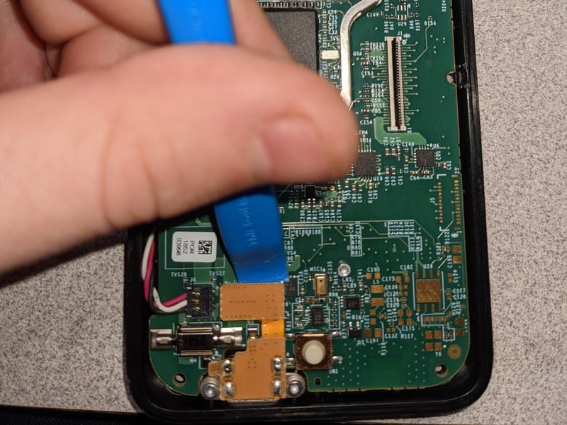

    1. Dexcom G6 Receiver Charging Port Replacement, Charging Port: step 3, image 1 of 1
      • Using a spudger, unplug the Charging Port connector from the motherboard.
      Ask FixBot
    2. Dexcom G6 Receiver Charging Port Replacement: step 4, image 1 of 1
      • Remove the 2 silver Torx T5 screws holding the charging port down.
      Ask FixBot
    3. Dexcom G6 Receiver Charging Port Replacement: step 5, image 1 of 1
      • Remove the Charging Port Assembly from the motherboard.
      Ask FixBot

Where can the part be purchased?
Mayor of Koala Corner - Reply Share
I'm not sure if there is a replacement charging port assembly available online. If you're good at microsoldering, you could replace the surface mount micro USB port on the assembly.
Andrew S - Reply Share
where can the part be purchased?
would a cell phone repair shop be able to do this?
Ron Magliacane - Reply Share
If they are comfortable with it. Tell them it will probably require microsoldering.
