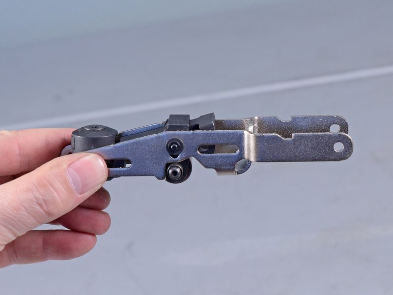

    4. Dewalt Nailers PTO Assembly Replacement: step 18, image 1 of 1
      • Only the PTO assembly remains.
