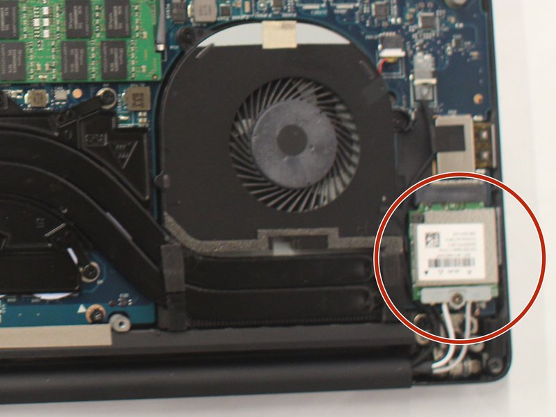

    1. Dell XPS 15 9550 Wireless Card Replacement, Wireless Card: step 4, image 1 of 1
      • With a Philips #00 Screwdriver bit, remove one 4 mm long black screw located by the antenna connections on the wireless card.
      • Set the screw and metal holder aside.
      Ask FixBot
    2. Dell XPS 15 9550 Wireless Card Replacement: step 5, image 1 of 2 Dell XPS 15 9550 Wireless Card Replacement: step 5, image 2 of 2
      • Gently lift up each of the antennas (3) to disconnect them from the wireless card.
      • These are similar to a coat button, the antennas snap on and snap off.
      Ask FixBot
    3. Dell XPS 15 9550 Wireless Card Replacement: step 6, image 1 of 3 Dell XPS 15 9550 Wireless Card Replacement: step 6, image 2 of 3 Dell XPS 15 9550 Wireless Card Replacement: step 6, image 3 of 3
      • With the antennas disconnected, gently pull the wireless card out at the angle it sits at.
      • The wireless card has been successfully removed!
