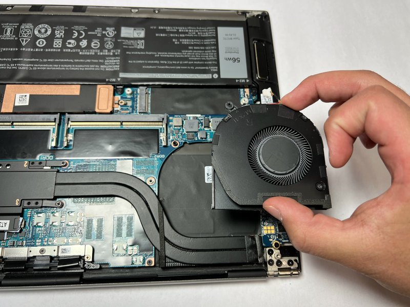

    4. Dell XPS 15 9510 Fan Replacement: step 7, image 1 of 2 Dell XPS 15 9510 Fan Replacement: step 7, image 2 of 2
      • Gently slide and then lift the fans out of their positions.
      Ask FixBot
    5. Dell XPS 15 9510 Fan Replacement: step 8, image 1 of 3 Dell XPS 15 9510 Fan Replacement: step 8, image 2 of 3 Dell XPS 15 9510 Fan Replacement: step 8, image 3 of 3
      • Repeat the previous step and remove the other fan.
