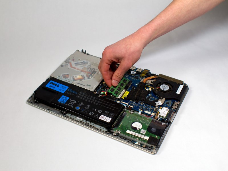

    1. Dell XPS 14Z L412Z RAM Replacement, RAM: step 3, image 1 of 1
      • Locate the RAM on the motherboard.
      Ask FixBot
    2. Dell XPS 14Z L412Z RAM Replacement: step 4, image 1 of 1
      • Carefully pull on the tabs on either sides of the RAM.
      Ask FixBot
    3. Dell XPS 14Z L412Z RAM Replacement: step 5, image 1 of 1
      • Carefully pull the old RAM out.
