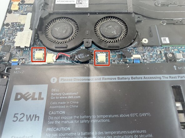

      • Unplug the two black cables from the motherboard assembly.
      • Move the cables out of the way and lift the cooling fan assembly out of the frame.

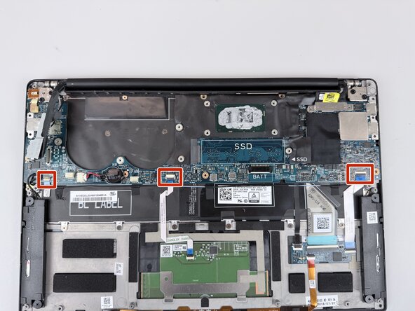

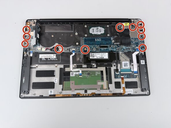

    1. Dell XPS 13 9370 Motherboard Replacement, Motherboard: step 10, image 1 of 2 Dell XPS 13 9370 Motherboard Replacement, Motherboard: step 10, image 2 of 2
      • Remove the eleven 3.4 mm screws holding the motherboard in place using a Phillips #1 screwdriver.
      Ask FixBot

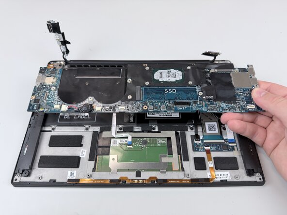

    2. Dell XPS 13 9370 Motherboard Replacement: step 11, image 1 of 2 Dell XPS 13 9370 Motherboard Replacement: step 11, image 2 of 2
      • Unplug the three white ribbon cable connectors.
      • Gently pry the motherboard loose and lift the assembly out of the frame.
