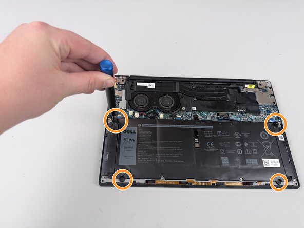

    2. Dell XPS 13 9370 Battery Replacement: step 4, image 1 of 3 Dell XPS 13 9370 Battery Replacement: step 4, image 2 of 3 Dell XPS 13 9370 Battery Replacement: step 4, image 3 of 3
      • Remove the silver 4 mm screw from the top of the battery using a Phillips #000 screwdriver.
      • Remove the four black 2 mm screws holding in the battery along the edges using a Phillips #1 screwdriver.
      • Lift the battery out of the laptop.
