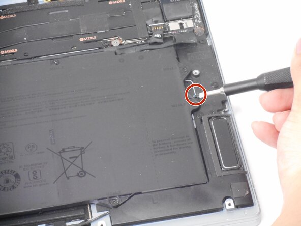

    1. Dell XPS 13 9315 Touchpad Replacement, Battery: step 5, image 1 of 3 Dell XPS 13 9315 Touchpad Replacement, Battery: step 5, image 2 of 3 Dell XPS 13 9315 Touchpad Replacement, Battery: step 5, image 3 of 3
      • Use a Phillips #0 screwdriver to remove the eight M2x3 screws securing the battery.
      Ask FixBot
    2. Dell XPS 13 9315 Touchpad Replacement: step 6, image 1 of 2 Dell XPS 13 9315 Touchpad Replacement: step 6, image 2 of 2
      • Lift the battery up and out of the chassis.
      Ask FixBot

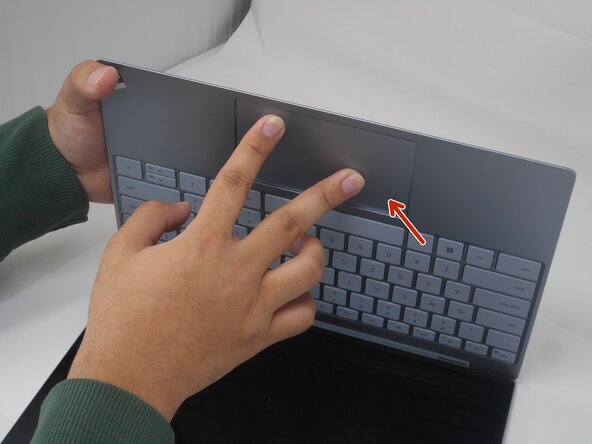

    3. Dell XPS 13 9315 Touchpad Replacement: step 9, image 1 of 3 Dell XPS 13 9315 Touchpad Replacement: step 9, image 2 of 3 Dell XPS 13 9315 Touchpad Replacement: step 9, image 3 of 3
      • Open the laptop and with your hand behind the touchpad, and push the bottom of the touchpad.
      • Pull out the touch pad by pulling away from its slot.
      Ask FixBot
