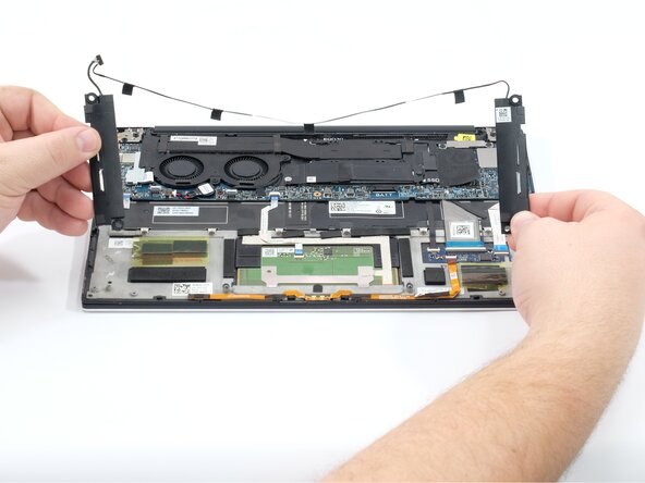

    4. Dell XPS 13 7390 Speaker Module Replacement: step 6, image 1 of 1
      • Lift each speaker straight up from the chassis using your fingers.
      • Check that the cable is fully free so it does not snag while removing the speakers.
      • Remove both speaker modules and set them on a safe, clean surface.
