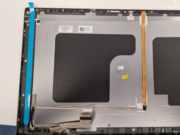

    5. Dell Vostro 5510 Display LCD Replacement, LCD Removal: step 13, image 1 of 2 Dell Vostro 5510 Display LCD Replacement, LCD Removal: step 13, image 2 of 2
      • Set the bezle to one side and attack the screen next
      • There are 2x addisive strips holding the screen in
      • Locate the pull tabs and gently pull on them to release the adicive
      • Take care not the break the strips when removing as they are fragile and screen is difficult to remove with these in place.
      • Gently lifting one side of the screen can help release any strip that couldn't be pulled out with the tabs.

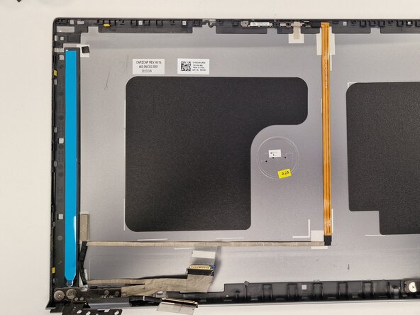

    7. Dell Vostro 5510 Display LCD Replacement, LCD Install: step 15, image 1 of 3 Dell Vostro 5510 Display LCD Replacement, LCD Install: step 15, image 2 of 3 Dell Vostro 5510 Display LCD Replacement, LCD Install: step 15, image 3 of 3
      • Replace the strips ensuring the new pull tabs are aligned at the bottom.
      • Some strips come supplied too long and will require trimming.
      Ask FixBot
    8. Dell Vostro 5510 Display LCD Replacement, LCD Install: step 16, image 1 of 2 Dell Vostro 5510 Display LCD Replacement, LCD Install: step 16, image 2 of 2
      • Connect the display cable to the new screen and ensure the cables are positioned correctly running through the hindge
      • Align the display with he top of the lid first
      • Gently lower the screen on to the new strips ensuring display cable remains in correct position.
