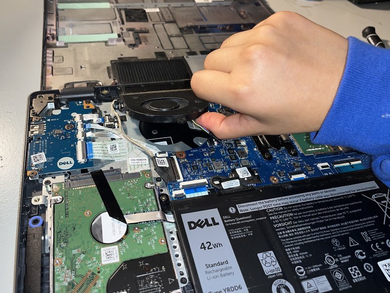

    3. Dell Vostro 3400 Fan Replacement: step 3, image 1 of 3 Dell Vostro 3400 Fan Replacement: step 3, image 2 of 3 Dell Vostro 3400 Fan Replacement: step 3, image 3 of 3
      • Remove the two screws that hold the fan in place using the Phillips #00 screwdriver.
      Ask FixBot
    4. Dell Vostro 3400 Fan Replacement: step 4, image 1 of 3 Dell Vostro 3400 Fan Replacement: step 4, image 2 of 3 Dell Vostro 3400 Fan Replacement: step 4, image 3 of 3
      Tool used on this step:
      Buy
      • Detach the brown wire coiled around the fan using a pair of tweezers.
      Ask FixBot
    5. Dell Vostro 3400 Fan Replacement: step 5, image 1 of 3 Dell Vostro 3400 Fan Replacement: step 5, image 2 of 3 Dell Vostro 3400 Fan Replacement: step 5, image 3 of 3
      • Pull out the connection between the fan and the motherboard.
      Ask FixBot
    6. Dell Vostro 3400 Fan Replacement: step 6, image 1 of 1
      • Remove the fan from the laptop.
      Ask FixBot
