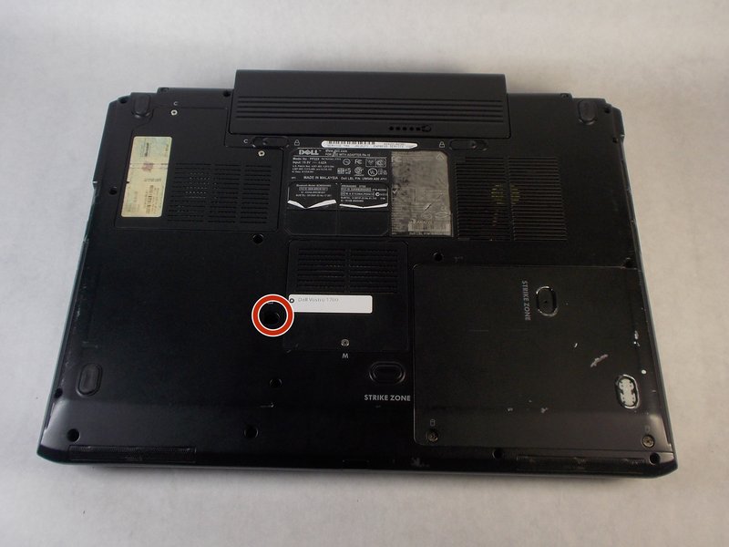

This guide instructs you on how to replace the Optical Disc Drive from the Dell Vostro 1700 laptop. This very short and straight forward guide will help make your device read from and write to discs again.
Tools
    1. Dell Vostro 1700 Optical Disc Drive Replacement, Optical Disc Drive: step 1, image 1 of 2 Dell Vostro 1700 Optical Disc Drive Replacement, Optical Disc Drive: step 1, image 2 of 2
      • Power off the device before disassembly.
      • Remove the single 8mm Phillips #1 screw just beneath the lock symbol on the bottom of the laptop.
