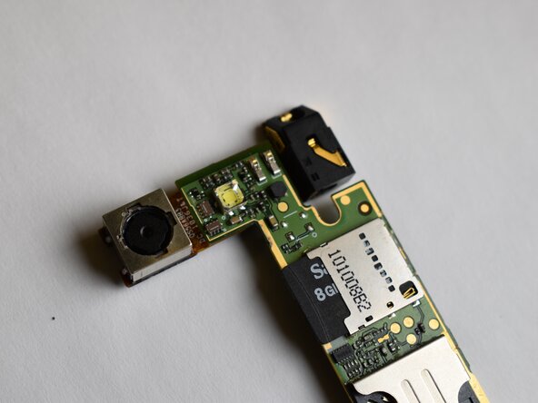

    9. Dell Venue Pro Rear Camera Assembly Replacement: step 9, image 1 of 1
      • Starting from the top edge, gently lift the motherboard up and away from the phone housing.
      • Locate the rear camera assembly on the motherboard.
      • Gently lift the rear camera assembly straight up to disconnect it from its socket.
      • Remove the rear camera assembly from the motherboard.
      • Do not pry on the camera lens. Apply pressure only to the edges of the camera module.
      Ask FixBot
    10. Dell Venue Pro Rear Camera Assembly Replacement: step 10, image 1 of 1
      • Install the New Rear Camera Assembly
      • Align the replacement rear camera assembly with its socket on the motherboard.
      • Press gently on the edges of the camera module until it is fully seated.
      • Do not press on the camera lens. Apply pressure only to the edges of the camera module.
