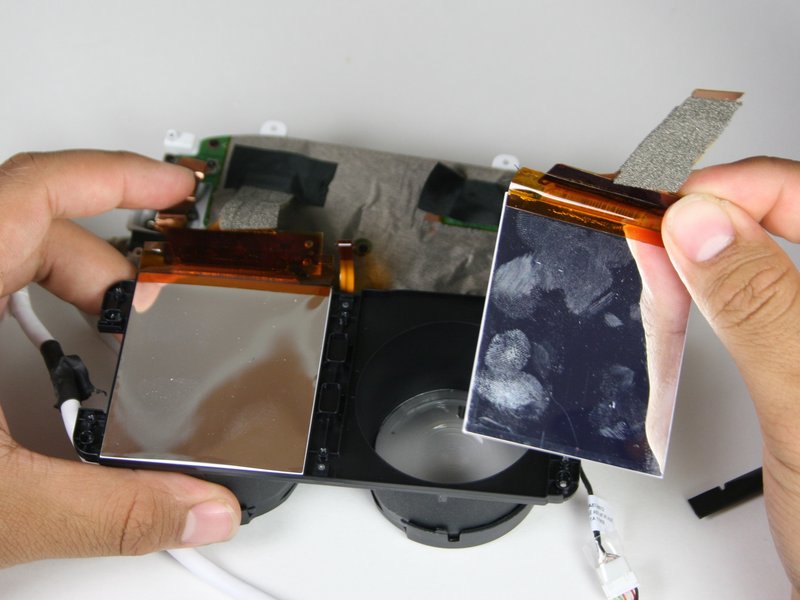

    5. Dell VRP100 Screen Replacement: step 9, image 1 of 3 Dell VRP100 Screen Replacement: step 9, image 2 of 3 Dell VRP100 Screen Replacement: step 9, image 3 of 3
      • Peel away the screen with both hands.
      • A plastic opening tool may be required for removing the screen.
      • Adhesive may need to be reapplied during the rebuild.
