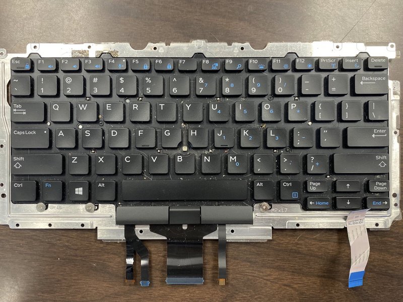

    1. Dell Latitude E7470 Keyboard Replacement, Keyboard: step 9, image 1 of 3 Dell Latitude E7470 Keyboard Replacement, Keyboard: step 9, image 2 of 3 Dell Latitude E7470 Keyboard Replacement, Keyboard: step 9, image 3 of 3
      • Use a Phillips #0 screwdriver to remove the seventeen 4 mm screws.
      Ask FixBot
    2. Dell Latitude E7470 Keyboard Replacement: step 10, image 1 of 2 Dell Latitude E7470 Keyboard Replacement: step 10, image 2 of 2
      • Disconnect the four ribbon wires labeled by the red rectangles by pushing aside the metal release tab and gently pulling the ribbon wire.
      Ask FixBot
    3. Dell Latitude E7470 Keyboard Replacement: step 11, image 1 of 2 Dell Latitude E7470 Keyboard Replacement: step 11, image 2 of 2
      • Remove the keyboard from the device.
      Ask FixBot

I have the E7470 without the pointer and the keyboard isn't backlit and it doesn't have the palm rest above the touchpad. I have found a backlit keyboard on eBay (unlike the keyboard in this tutorial) that looks identical to mine but only has 2 ribbons. I'm guessing one for the keyboard and for the backlight. My motherboard has a spare connector next to the main ribbon (here are the pics of my motherboard and the keyboard I'm referring to: https://www.dell.com/community/Latitude/... - the 2 pics at the bottom of the thread). The connector I'm referring to is the same as the one marked by the red square on the far right of the pic at Step 10 of this tutorial. Am I correct in assuming that this is the connector for the backlight?
