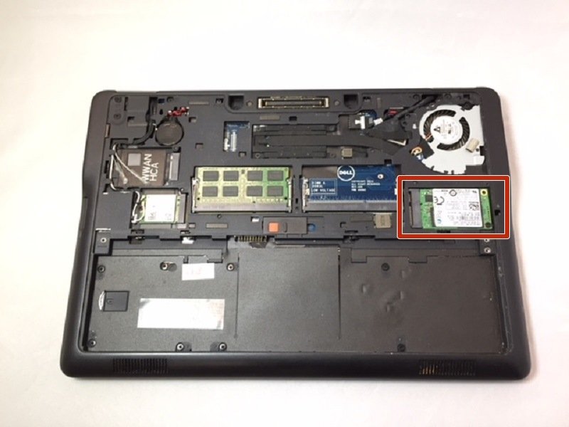

    1. Dell Latitude E7250 SSD Replacement, SSD: step 2, image 1 of 3 Dell Latitude E7250 SSD Replacement, SSD: step 2, image 2 of 3 Dell Latitude E7250 SSD Replacement, SSD: step 2, image 3 of 3
      • With the battery removed two screws will be visible. These will need to be removed.
      • Placing your hands on either side of the panel, push down and pull back to slide the plate back and off.
      Ask FixBot
    2. Dell Latitude E7250 SSD Replacement: step 3, image 1 of 3 Dell Latitude E7250 SSD Replacement: step 3, image 2 of 3 Dell Latitude E7250 SSD Replacement: step 3, image 3 of 3
      • Locate your SSD, it is on the right side and held in with a small screw.
      • Unscrew the SSD carefully. Once done, the SSD will "pop" upwards at an angle making removal easy.
      • Gently grasp the SSD on either side with your thumb and forefinger and pull away from the computer.
