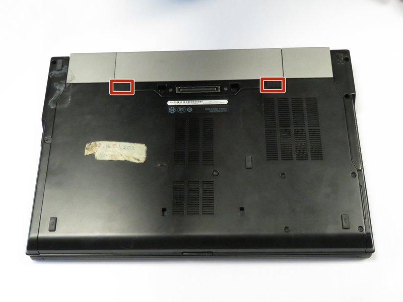

    1. Dell Latitude E6510  USB Ports Replacement, USB Ports: step 4, image 1 of 2 Dell Latitude E6510  USB Ports Replacement, USB Ports: step 4, image 2 of 2
      • Remove the battery
      • Flip the computer so that it is facing downward.
      • Next locate the two black clips as shown in the image.
      • Slide the clips toward the middle in order to release the battery.
      Ask FixBot
