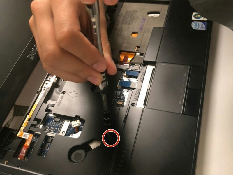

    1. Dell Latitude E4300 Keyboard Docking Component Replacement, Keyboard Docking Component: step 4, image 1 of 1
      • With your Phillips 1 screwdriver, unscrew the five M2.5x5-mm screws and the five M2.5x8-mm screws that lie underneath the keyboard panel.
      • Be aware there are two deeply recessed screws on both sides to the rear of this panel. There are also two screws externally on the rear face either side of the battery that hold the monitor on and pass through this panel, support the screen when you remove these. There are also two screws above the hard drive bay that need to be removed.
      Ask FixBot
    2. Dell Latitude E4300 Keyboard Docking Component Replacement: step 5, image 1 of 2 Dell Latitude E4300 Keyboard Docking Component Replacement: step 5, image 2 of 2
      • Remove additional wires located within the panel.
      • For the smaller wires, try using a spudger for easier access.
      Ask FixBot
    3. Dell Latitude E4300 Keyboard Docking Component Replacement: step 6, image 1 of 1
      • Lift the keyboard panel to separate the component from the rest of the device.
      Ask FixBot
