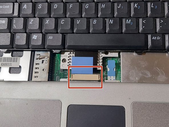

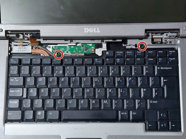

    1. Dell Latitude D510 Thermal Paste Replacement, Opening the laptop.: step 1, image 1 of 3 Dell Latitude D510 Thermal Paste Replacement, Opening the laptop.: step 1, image 2 of 3 Dell Latitude D510 Thermal Paste Replacement, Opening the laptop.: step 1, image 3 of 3
      • Use a prying tool to remove the top panel.
      • This will reveal 2 screws that hold the keyboard in place, remove them.
      • After that - carefully unplug the keyboard and set it aside.
