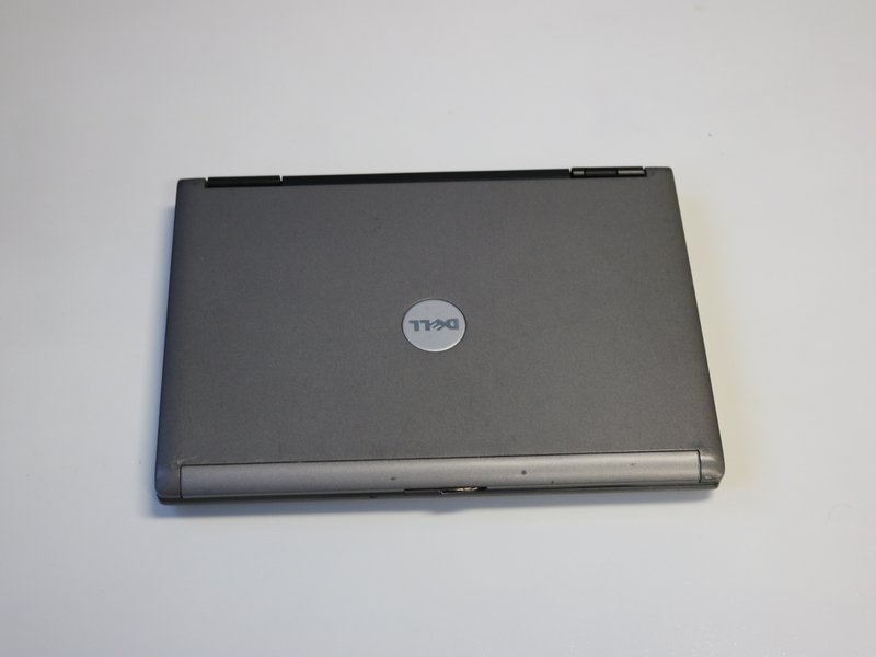

    1. Dell Latitude D430 Wireless Adapter Replacement, Wireless Adapter: step 1, image 1 of 3 Dell Latitude D430 Wireless Adapter Replacement, Wireless Adapter: step 1, image 2 of 3 Dell Latitude D430 Wireless Adapter Replacement, Wireless Adapter: step 1, image 3 of 3
      • Flip the laptop so you are able to see the bottom.
