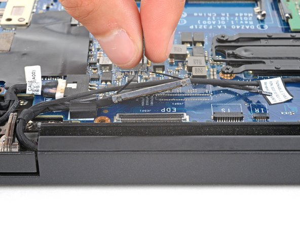

    2. Dell Latitude 7490 Screen Replacement, Disconnect the ASA and IR cables (if applicable): step 12, image 1 of 3 Dell Latitude 7490 Screen Replacement, Disconnect the ASA and IR cables (if applicable): step 12, image 2 of 3 Dell Latitude 7490 Screen Replacement, Disconnect the ASA and IR cables (if applicable): step 12, image 3 of 3
      Tool used on this step:
      Buy
      • Use blunt nose tweezers to firmly grip the antenna cable by the tape just below its connector.
      • Pull the connector straight out of its socket.
      • Grip the IR cable by its tape and pull it out of its socket.
      • Follow the same method for the touchscreen (TS) connector if applicable
      • Not all configurations are equipped with the IR camera, Active Steering Antenna (ASA, labeled ANT), or touchscreen (labeled TS).

    3. Dell Latitude 7490 Screen Replacement, Remove the display cable bracket: step 13, image 1 of 3 Dell Latitude 7490 Screen Replacement, Remove the display cable bracket: step 13, image 2 of 3 Dell Latitude 7490 Screen Replacement, Remove the display cable bracket: step 13, image 3 of 3
      • Use a Phillips screwdriver to remove the 5.7 mm‑long screw securing the display cable bracket.
      • Remove the display cable bracket.
      Ask FixBot
    4. Dell Latitude 7490 Screen Replacement, Disconnect the display cable: step 14, image 1 of 2 Dell Latitude 7490 Screen Replacement, Disconnect the display cable: step 14, image 2 of 2
      • Grip the plastic tab on the display cable connector and pull straight up to disconnect it.
      Ask FixBot
