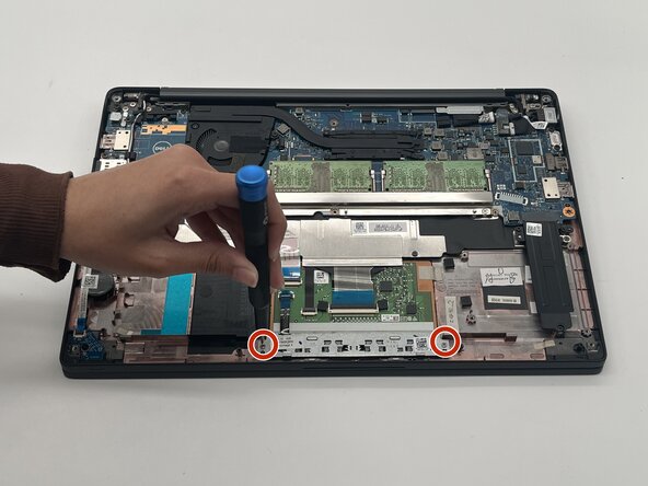

    6. Dell Latitude 7400 Touchpad Key Replacement: step 8, image 1 of 3 Dell Latitude 7400 Touchpad Key Replacement: step 8, image 2 of 3 Dell Latitude 7400 Touchpad Key Replacement: step 8, image 3 of 3
      • Use a Phillips #0 screwdriver to remove the two screws on the touchpad keys.
      • Remove the touchpad keys.
