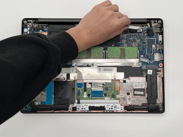

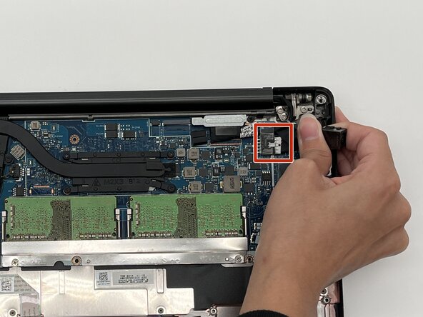

    2. Dell Latitude 7400 Motherboard Replacement: step 4, image 1 of 2 Dell Latitude 7400 Motherboard Replacement: step 4, image 2 of 2
      • Gently pull the display cable connector and move the power adaptor cord to the side.

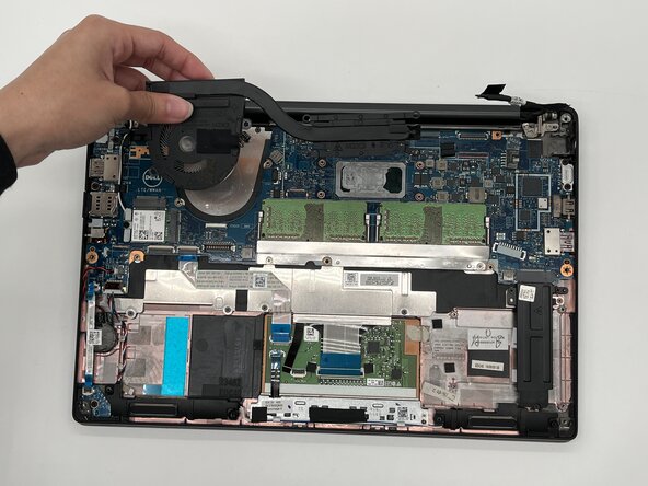

    5. Dell Latitude 7400 Motherboard Replacement: step 7, image 1 of 3 Dell Latitude 7400 Motherboard Replacement: step 7, image 2 of 3 Dell Latitude 7400 Motherboard Replacement: step 7, image 3 of 3
      • Use a Phillips #0 screw and unscrew the seven 3 mm screws that secure the fan and heat sink.
      • Remove the fan and heat sink and set it aside.

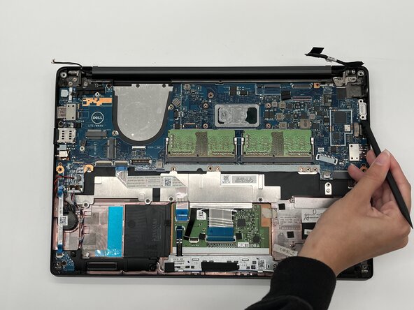

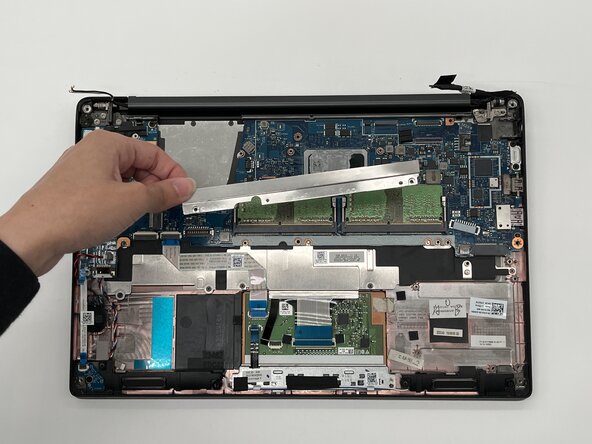

    8. Dell Latitude 7400 Motherboard Replacement: step 10, image 1 of 3 Dell Latitude 7400 Motherboard Replacement: step 10, image 2 of 3 Dell Latitude 7400 Motherboard Replacement: step 10, image 3 of 3

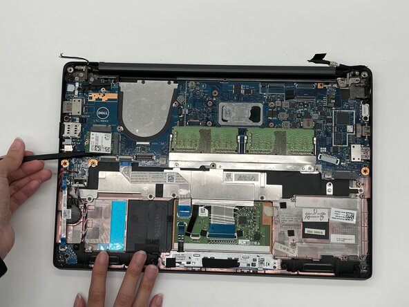

      • Remove the the two Phillips screws on the metal bracket beneath the RAM modules.
      • Remove the bracket.

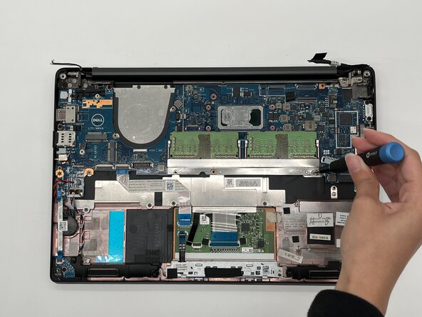

    9. Dell Latitude 7400 Motherboard Replacement: step 11, image 1 of 3 Dell Latitude 7400 Motherboard Replacement: step 11, image 2 of 3 Dell Latitude 7400 Motherboard Replacement: step 11, image 3 of 3

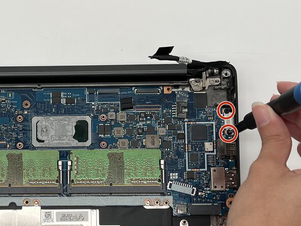

      • Remove the two 3 mm Phillips screws.
      • Using a spudger, gently lift the metal plate and set it aside.

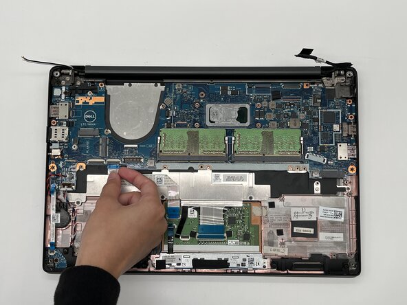

    11. Dell Latitude 7400 Motherboard Replacement: step 13, image 1 of 3 Dell Latitude 7400 Motherboard Replacement: step 13, image 2 of 3 Dell Latitude 7400 Motherboard Replacement: step 13, image 3 of 3
      • Flip up the locking ZIF locking flap securing the ribbon cable.
      • Disconnect the ribbon cable.

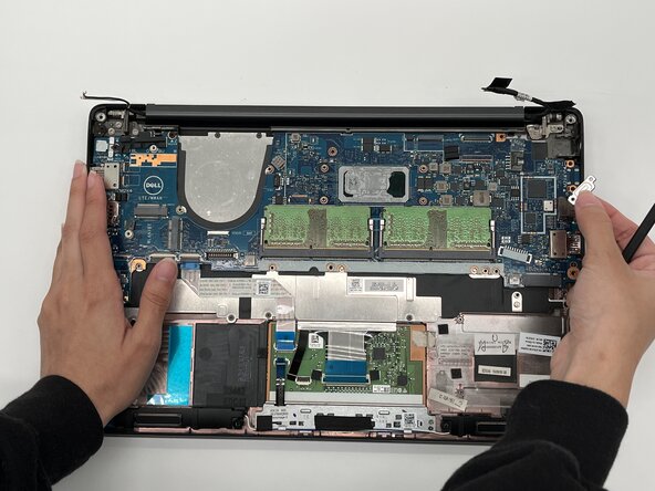

    13. Dell Latitude 7400 Motherboard Replacement: step 15, image 1 of 2 Dell Latitude 7400 Motherboard Replacement: step 15, image 2 of 2
      • Gently grab and lift the old motherboard and set it aside.
      • Get a new motherboard and place it in the space where the old motherboard was.
