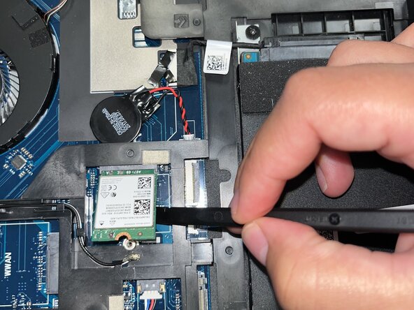

    3. Dell Latitude 5580 Wi-Fi Card Replacement: step 4, image 1 of 2 Dell Latitude 5580 Wi-Fi Card Replacement: step 4, image 2 of 2
      • Use a spudger or your finger to gently lift the Wi-Fi card.
      Ask FixBot

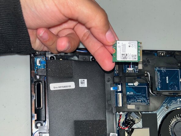

    4. Dell Latitude 5580 Wi-Fi Card Replacement: step 5, image 1 of 2 Dell Latitude 5580 Wi-Fi Card Replacement: step 5, image 2 of 2
      • Remove the Wi-Fi card.
