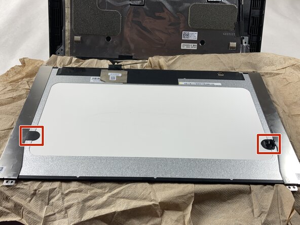

    3. Dell Latitude 5500 Display Replacement: step 7, image 1 of 3 Dell Latitude 5500 Display Replacement: step 7, image 2 of 3 Dell Latitude 5500 Display Replacement: step 7, image 3 of 3
      • Pull out the black adhesive using the tabs to remove the metal connectors from the display.
      • Be careful when pulling the tab out. If it snaps before you're finished, and you lose hold of the adhesive, you may need to use prying tools instead. This takes longer and risks bending the metal connectors.

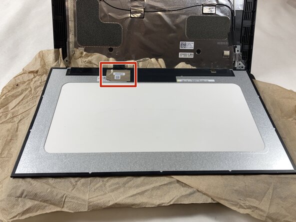

    4. Dell Latitude 5500 Display Replacement: step 8, image 1 of 3 Dell Latitude 5500 Display Replacement: step 8, image 2 of 3 Dell Latitude 5500 Display Replacement: step 8, image 3 of 3
      • Remove the tape to fully disconnect the display.
