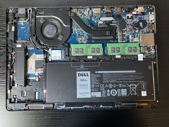

    1. Dell Latitude 5491 Battery Replacement, Remove Backplate: step 1, image 1 of 1
      • Begin by removing the back plate by loosening the eight captive screws on the back plate.
      • Use a prying tool to lift up the back plate and work around the edges to remove it.

    2. Dell Latitude 5491 Battery Replacement, Remove the Battery: step 2, image 1 of 3 Dell Latitude 5491 Battery Replacement, Remove the Battery: step 2, image 2 of 3 Dell Latitude 5491 Battery Replacement, Remove the Battery: step 2, image 3 of 3
      • Once the back plate is off, remove the battery cable. To do so, pull upwards on the flexible black handle attached to the battery cable.
      • Once the battery cable is removed, you must remove the captive screw which is holding the battery down, as marked by the screw icon printed on the battery (the non crossed-out one).
      • Then push the battery forwards slightly toward the motherboard and pull the battery out.

    3. Dell Latitude 5491 Battery Replacement, Replace the Battery: step 3, image 1 of 2 Dell Latitude 5491 Battery Replacement, Replace the Battery: step 3, image 2 of 2
      • Once the old battery is removed, insert the new battery at an angle, making sure the tabs on the bottom of the battery go in the correct location.
      • Once the battery is in place, reconnect the battery cable and retighten the captive screw.
