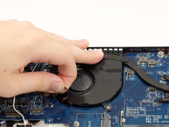

    1. Dell Latitude 5490 Fan Replacement, Fan: step 22, image 1 of 3 Dell Latitude 5490 Fan Replacement, Fan: step 22, image 2 of 3 Dell Latitude 5490 Fan Replacement, Fan: step 22, image 3 of 3
      • Remove the fan connector from the system board.
      Ask FixBot
    2. Dell Latitude 5490 Fan Replacement: step 23, image 1 of 2 Dell Latitude 5490 Fan Replacement: step 23, image 2 of 2
      • Lift the fan out of the laptop.
      Ask FixBot
