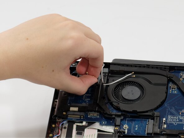

    1. Dell Latitude 5490 Chassis Frame Replacement, WLAN (WiFi Card): step 14, image 1 of 1
      • Remove the 4 mm screw holding the bracket above the WLAN card with a Phillips #0 screwdriver.
      • Be careful with the antenna connectors located under the bracket. They are fragile. If damaged, you will not be able to access Wi-Fi.
      Ask FixBot
    2. Dell Latitude 5490 Chassis Frame Replacement: step 15, image 1 of 3 Dell Latitude 5490 Chassis Frame Replacement: step 15, image 2 of 3 Dell Latitude 5490 Chassis Frame Replacement: step 15, image 3 of 3
      • Carefully remove both antenna connectors. Ensure that you pull the antenna connectors straight up from the socket.
      • Using angled tweezers, hook one end of the tweezer under the connector. Set the other side at the end of the connector on the WLAN card. Keeping the tweezers flat, lightly squeeze.
      • These connectors are extremely fragile; ensure that they are aligned properly.
      • For reassembly, ensure that the antenna connectors are aligned above the sockets and press down gently. There should be a slight click. There should not be tension or resistance while doing so.
      Ask FixBot

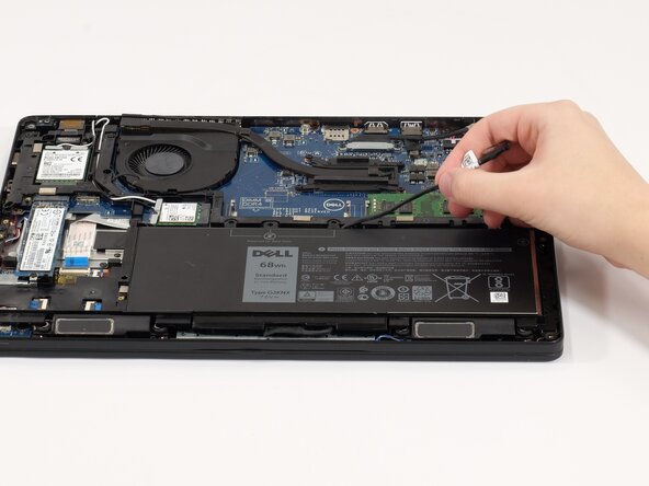

    1. Dell Latitude 5490 Chassis Frame Replacement, Chassis Frame: step 17, image 1 of 3 Dell Latitude 5490 Chassis Frame Replacement, Chassis Frame: step 17, image 2 of 3 Dell Latitude 5490 Chassis Frame Replacement, Chassis Frame: step 17, image 3 of 3
      • Using the angled tweezers, lift the small latches on the ribbon cables that are routed through the chassis. Gently remove them.
      • These cables and their connectors are extremely fragile; exercise caution when removing/inserting them.
      Ask FixBot
    2. Dell Latitude 5490 Chassis Frame Replacement: step 18, image 1 of 3 Dell Latitude 5490 Chassis Frame Replacement: step 18, image 2 of 3 Dell Latitude 5490 Chassis Frame Replacement: step 18, image 3 of 3
      • Unroute the WLAN and WWAN antenna cables from the chassis frame.
      Ask FixBot
