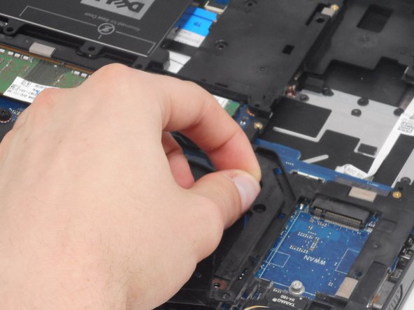

    1. Dell Latitude 5480 Fan Replacement, Dell Latitude 5480 Battery Disconnection: step 3, image 1 of 2 Dell Latitude 5480 Fan Replacement, Dell Latitude 5480 Battery Disconnection: step 3, image 2 of 2
      • Grip the black battery cable connector loop and pull it directly up to disconnect the battery.
