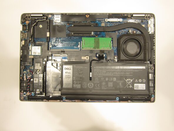

  3. Dell Latitude 5430 Battery Replacement, Dell Latitude 5430 Battery Disconnection: step 3, image 1 of 2 Dell Latitude 5430 Battery Replacement, Dell Latitude 5430 Battery Disconnection: step 3, image 2 of 2
    • Grip the battery connector pull-tab and lift it straight up to disconnect the battery.
    Ask FixBot
  4. Dell Latitude 5430 Battery Replacement, Battery: step 4, image 1 of 2 Dell Latitude 5430 Battery Replacement, Battery: step 4, image 2 of 2
    • Remove the three M2x5 screws securing the battery with a Phillips #1 screwdriver.
    Ask FixBot
  5. Dell Latitude 5430 Battery Replacement: step 5, image 1 of 2 Dell Latitude 5430 Battery Replacement: step 5, image 2 of 2
    • Lift and remove the battery.
    Ask FixBot
