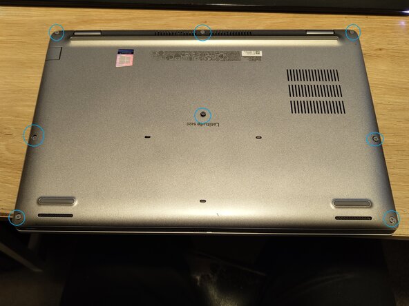

      • Overall this is a pretty easy cover to remove - there are 8 encapsulated screws to remove, all Philips #0. Start by loosening all 8 of these screws.
      Ask FixBot
      • After you've loosened all the screws, you should be able to pry underneath the cover between the screen hinges and gently lift the cover and separate the clips that hold the cover on to the main chassis. Once these are removed the cover should pop free.
