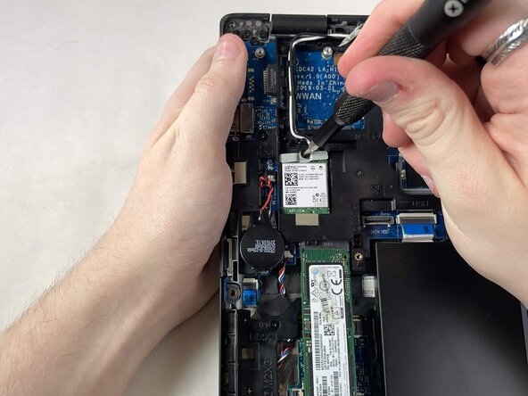

    2. Dell Latitude 5401 Wi-Fi Card Replacement: step 5, image 1 of 3 Dell Latitude 5401 Wi-Fi Card Replacement: step 5, image 2 of 3 Dell Latitude 5401 Wi-Fi Card Replacement: step 5, image 3 of 3
      • Remove the 4mm Phillips #1 screw at the top of the card.
      • Remove the metal bracket.

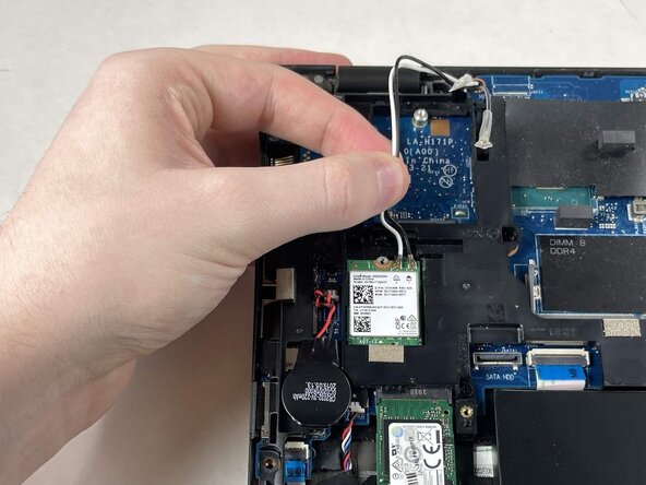

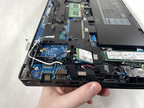

    3. Dell Latitude 5401 Wi-Fi Card Replacement: step 6, image 1 of 3 Dell Latitude 5401 Wi-Fi Card Replacement: step 6, image 2 of 3 Dell Latitude 5401 Wi-Fi Card Replacement: step 6, image 3 of 3
      • Use the pointed end of a spudger to lift and disconnect the two antenna cables.

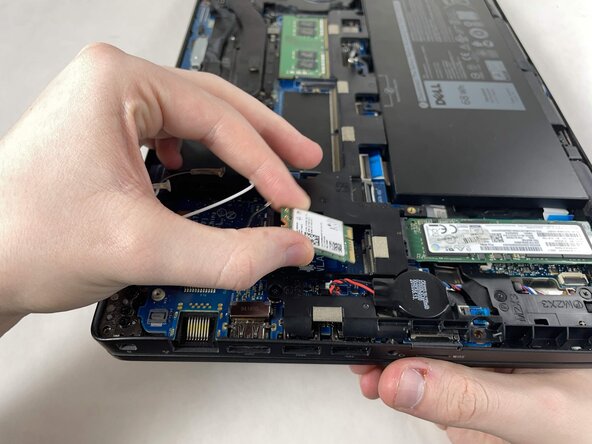

    4. Dell Latitude 5401 Wi-Fi Card Replacement: step 7, image 1 of 3 Dell Latitude 5401 Wi-Fi Card Replacement: step 7, image 2 of 3 Dell Latitude 5401 Wi-Fi Card Replacement: step 7, image 3 of 3
      • Carefully pull the card out of its socket.
